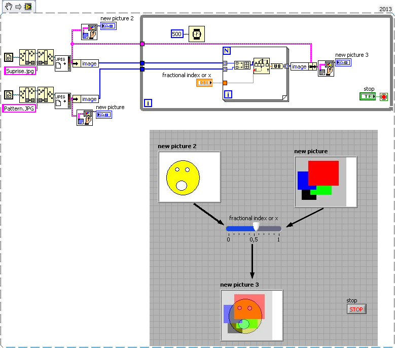

What if the image is not RGBU32? I'm looking to incorporate something similar into my code. What I'm attempting to do is capture an image using imaqdx snap2 vi, save that image to a file, then recall that image to overlay onto a live image later on in the application. Seems to me I would have to convert the saved image to a bitmap then overlay the bitmap onto the live image somehow. Does this sound feasible?
(3,576 Views)
hi jj0325,
how about something like this:
I have to admit, I did not write this piece of code on my own. I found this some years ago on the ni.forums, unfortunately I can't find the source-link anymore ....
Alex
