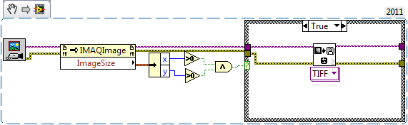

One method for checking if a valid image is present at the output from the "IMAQdx Get Image" VI is to use a "ImageSize" Property Node, unbundle the data from that property node and monitor if the "x" and "y" sizes of the image are greater than Zero.
If both "x" and "y" are greater than Zero than a valid image is present and can be saved, otherwise pass the reference around the while loop. The VI snippet below illustrates the principle. If you have LabVIEW 2011 simply drag the image into your existing Block Diagram to use the code.
