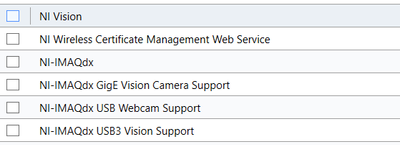

Hello Gabson,
You should not face issues while executing your code on your cRIO target and make the necessary measurements.
I hardly doubt that the drivers are not available for cRIO, in fact they are available:
