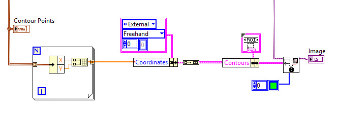

This can work for You:
This is good example about ROIs:

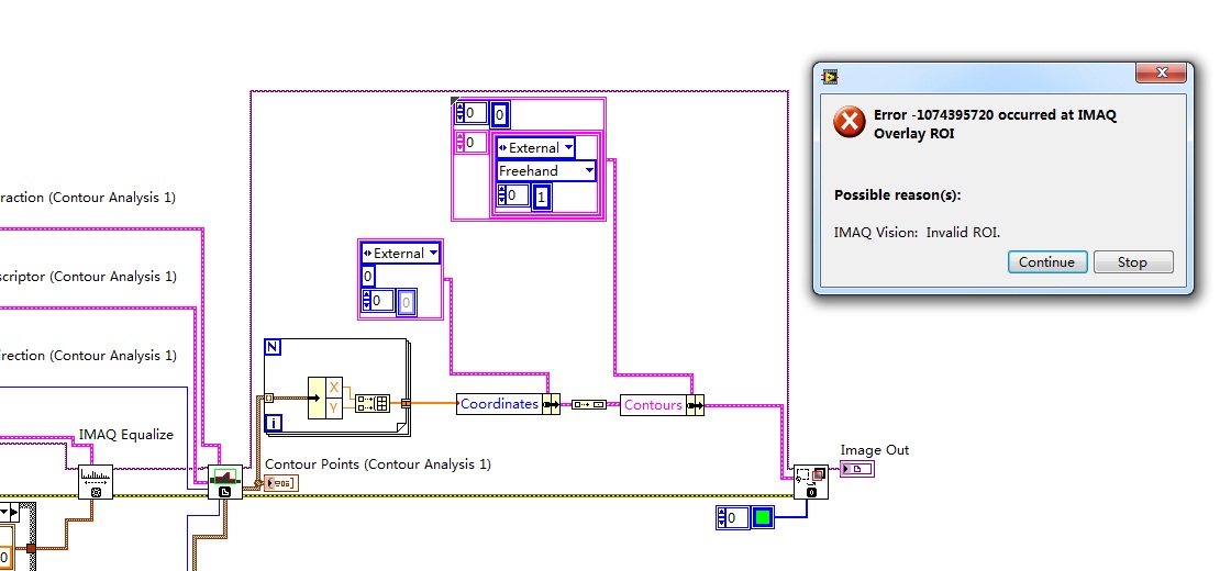

I tried , seems like the ROI is invalid.
