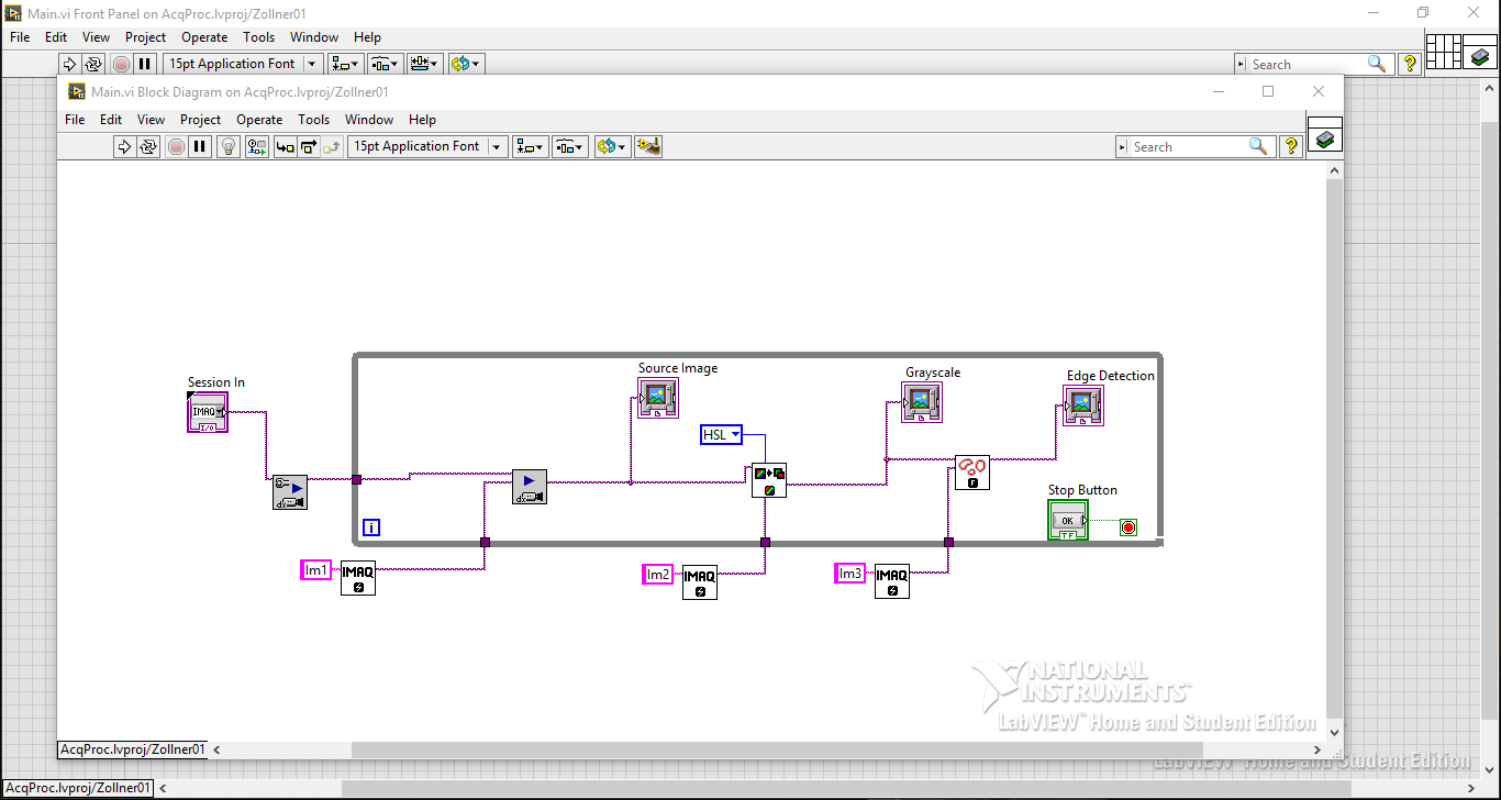

About, LabVIEW, I understand what you say, I also made a VI to see what functions are used:
Here I saw the imaqExtractColorPlanes planes and I searched it in Vision's Help. I still don't understand why is not working because it's the same code translated from LabVIEW to C.
