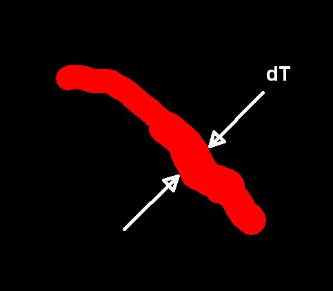

In my project after golden template comparison get I image with defects.
For me are those defects (particles) relevant that has a thickness greater than a given value.

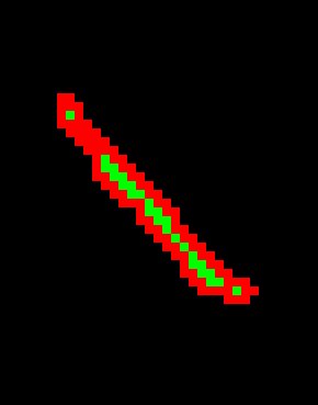

Of course I tried all methodes and measurements in "Particle Measurements". My problem is a known problem and as far as I know there's no simple answer for my question. Defects (particles) that I get are not always linear. They have almost always rotations.

I'm trying to eliminate all particles with thickniss less than for a given value.That means, all defects (particles) with thickness less than given value are not important. They must be filtered.

There is a way to filter particles based on erosion.  If the particle still remains after N erosions, it is kept.  Otherwise, it is removed.  The function is IMAQ RemoveParticle.

With Bruce's suggestion I was able to solve my problem. But first part of my question remains still unanswered. How can one find out max particle thicknes (dT) or at least average particle thickness?

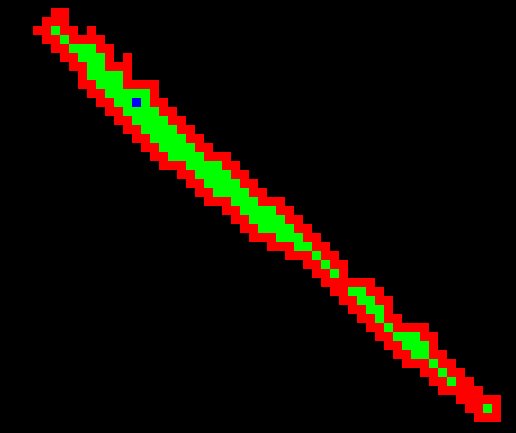

Create a binary image of your particles.
Use IMAQ Label to create a mask from the binary image with a new image as the destination. (mask)
Use IMAQ Danielsson to create an image that maps the distance from the edge for each pixel. (source)
Use IMAQ Quantify with the two new images as source and mask.  The output will be an array of measurements, one for each particle.  If you look at the max value for each particle, doubling it should give you the max width of the particle, since the max value is distance to the center of the particle at the widest point.  The max value also tells you how many erosions it would take to remove the particle.

You write: " If you look at the max value for each particle, doubling it should give you the max width of the particle, since the max value is distance to the center of the particle at the widest point.  "
Not always. It's like these arrays:
(a) 1, 2, 3, 3, 2, 1 : Max Value is 3. Doubling it gives max width of the particle: 2 x 3 = 6, correct
but
(2) 1, 2, 3, 2, 1: Max value is also 3. But doubling it don't five correct witdh. Correct witdt is "5"
or simpler
(3) 1,1 : max value is 1, width is 2
ok, but
(4) 1 : max value is 1 but width is 1
