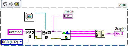

You just have to assemble your three histograph clusters in one array and display it in a graph:
Regards

Hi, here the same code in LV2010
Regards

Hi toto. Sorry for asking again. Actually I cannot find the function as in the red circle.

Build Array. That image is a code snippet, you can drag and drop it onto the block diagram in LabVIEW.
