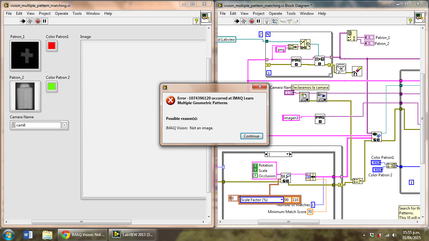

I've tried to modify the example of  "multiple geometric patterns matching" , and just use two patterns, but when I run the VI this error appear and I doon't know how to solve it! , the error appears in the "IMAQ Learn multiple geometric patterns" block.
Running on:
- labview 32 bits
- windows 7 64 bits
- usb camera 2.0
Any sugestion would be helpful..... !  Regards

My guess: There is something wrong with your template images.
Regrettably you have attached a different version of "vision_multiple_pattern_matching.vi" than the one that shows up in your post.  Can we please stick to one piece of code that exposes your problem?
(7,534 Views)
Hey.. are your template images really located in dropbox??
I would try using a path that doesn't contain an accent.
Try using a delay above 0 s
Greetings
(7,517 Views)
thanks all for your replies, the problem was on my template images, I had to give them information about the pattern matching, and I did it with NI Vision Template Editor, within Vision utilities, and I chose template with Feature Based.
