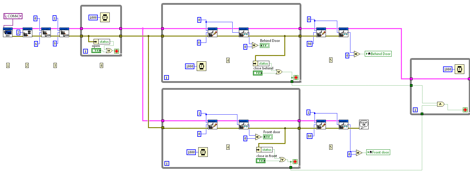

That`s my main software:
And I would like to add the code to acquire the images.
I know how to witte this code, but when i tried to add it. there are some problem. I can not see the picture pr use the motor.
Anyway I don`t know how to include the acquiring software.

    Please provide the actual code instead of the image. At my side this image is to blurred to be able to get enough information from it.
    Please also describe clearly what your current code should be doing. (Just describing what you expect each block/piece of your code to do should be ok)
    Also let us know what is currently "going wrong" / "not working" with it?

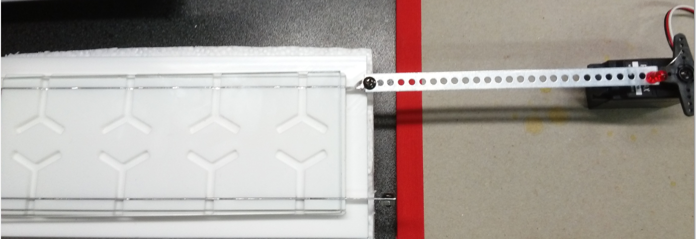

First here you will see on what I am working.
My motor is connected with and other piece of metal (inside the white block). In this piece there are some holes. With the motor I am going to shift all this piece of metal and the holes will be just in front off the way. (There are some flies at the beginning, and when I open the gates, they are able to go in the Y.
Then, my motor is connected to Arduino and I connected Arduino with LabVIEW. (it exist one Package)
In this code, there is not only one motor like in the previous picture but two, because there are two side in the white plastic block.
It is a simple code, at the beginning the doors of the piece of metal are close, when I push on "open", the motor turn, pull the peice of metal and the gates are open. and when I push on "Close behind door" or "Close front door" I can choose which one I want to close. The motor turn in the other sens and push the piece of metal to close the doors.
In this code, everything works very well, no trouble with that.

In fact, I don`t have some troubles with the camera..... I already build some software to record one video or just tak a picture or simple video. I know how to use the camera.
My problem is that I`m not able to add the two codes in the same.
I would like to have the code with the motor (showed in my second post) and also add one simple code to grab an imag. like in this video
https://www.youtube.com/watch?v=aJCxJLuAhTs
I tried to add the code for the camera just next to the code for the motor, but everything bug. (if I do that, sometime, the motor works whthout the camera, sometime the camera works without the motor......)
I`m sure I need just more knowledge with LabVIEW Vision.

I tried again, to find one solution...... I did this software but there is a lot of troubles. First I can not finish the software.... It goes round and round in circles in the while loop.... . I can not go out......
Secondly, with this kind of disposition, I have to close the two moteur in the same time.....
If I use the old software "close/open gates" there are two while loop. So I am even more lost.....
By the way, In the old software, I had one while loop at the beginning. In the new, I changed it with an Event Loop. What is the best for you? Because I know that normally the event Loop have to be used with a while loop.....

Hello Gerday,
Based on my understanding of your code you just want to have n additional "image monitoring loop" in parallel to your working "Simple open close the gates.vi" code.
Why don't you then put your "image acquisition/grabbing/monitoring loop" in parallel of the working code?
If it only needs to monitor the images, then this approach would be acceptable.
The thing you will have to make sure is that you stop your "image acquisition/grabbing/monitoring loop" when your code has finished running.
This could be done easily by using local/global variables.
