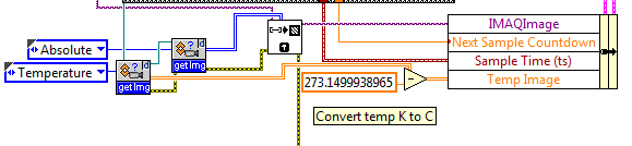

I'd thought would post some information on the FLIR Thermovision LabVIEW toolkit as I have used it alot in numerous applications with great success.
The main issue is getting temperature data from the image, which is not directly possible via IMAQ. I have done this using the Thermovision toolkit and converting the image to an array of temperature. As the FLIR cameras are low resolution, the arrays are not large datasets.
Here is a snippet using the FLIR Thermovision toolkit to convert extract the 'image' as array and convert to Deg. C.
