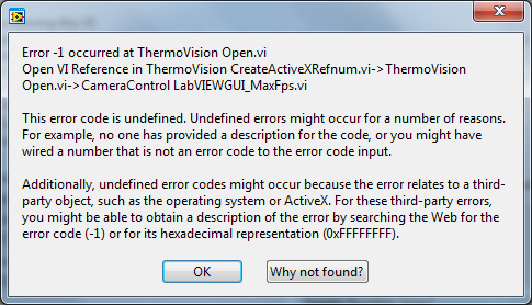

I am having issues with deploying an application with the FLIR Thermovision toolkit.  The execuatble works fine on the development machine but with the deploy machine I get the following error:
I can verify that the SDK runtime is installed and the OCX is registered in the registry but still no luck.  Does anyone have any thoughts?  I found this post:

The way you are describing your issue and seeing that the error is occuring from Open VI Reference and the fact that you ar seeing it on the depoyment system but not the development system, I have a feeling it's not reading the right path. Have a look at the following:
Why Does My Executable Not Work When Using the Current VI's Path Constant?
This is just my hunch, I could be totally wrong.

I ran into a similar problem recently...and it did turn out to be a problem where a file wasn't located where it needed to be.
I solved it by including the file itself in my project, not just as a dependancy, and making sure it's included in the build spec. (Under Source Files, I set this file to be 'always included')
(edit: you'll also want to go into "Source File Settings" and make sure this file has your .exe listed as its destination)
.user.lib\ThermoVision\ThermoVision.llb\ThermoVision CamCtrl.vit    <-- file in question
You have likely already figured this out, I just wanted to include it here in case anyone comes across this thread in the future.
