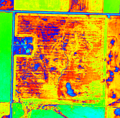

For example I want the image below

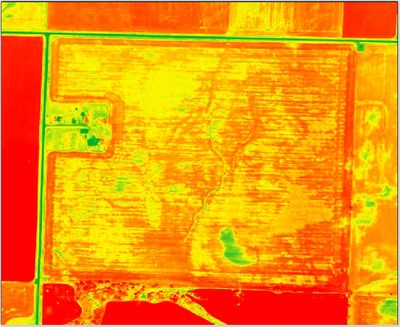

to look something like this,
the above image takes shades from red to green. Any help is appreciated.

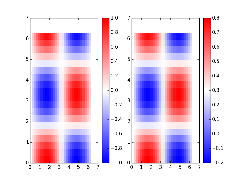

I am searching the color table of 256 values corresponding to the Red (Positive) Blue (Negative) colormap (like the sreenshot)
Could you help me to build the colors table please ?

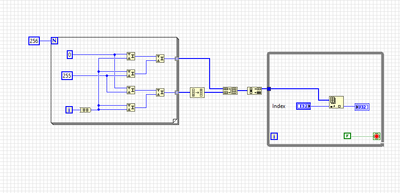

This will generate the color map you want
