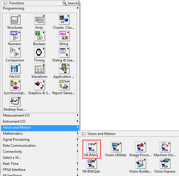

Ok, this information brings light into the issue.
The NI-IMAQ driver should appear in LabVIEW in the palett "Vision and Motion". See screenshot.

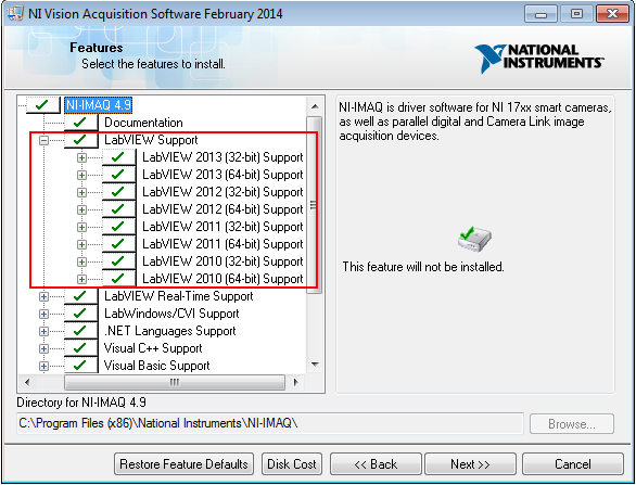

The latest version of this driver with support for LabVIEW 2014 can be found here:
NI Vision Acquisition Software February 2015 - National Instruments
http://www.ni.com/download/ni-vision-acquisition-software-february-2015/5149/en/
The Vision Acquisition Software provides the NI-IMAQ, the NI-IMAQdx and the NI-IMAQ I/O driver. You can tell the installer to only install NI-IMAQ. It is important to tell the installer to install support for LabVIEW 2014 (the screenshot is from another version of the installer, so don't be confused).
Can you find not the IMAQ palette in LabVIEW?

Thank you! Installing the latest version correctly fixed my problem. I hope it will work now!
