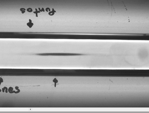

I'm having trouble to acquire a good quality picture of an object to search for cuts, scratches and holes, the object is a completely reflective cilinder. until now i've managed to get a good picture but the reflection of the camera is way difficult to delete with lighting. The current lighting technique i'm using is a Dome lighting:
the best picture i took:
That black particle is the reflection of the camera, What technique or type of lighting or trick can i use to get rid of that reflection?
thanks in advance
(4,883 Views)
I have seen a light that combined a dome light with on axis lighting.  The camera looks through the on axis light.  You would need to adjust the brightness of the two lights to match, but it should eliminate the picture of the lens.
Here is an example: http://smartvisionlights.com/products/diffuse-on-off-axis-light
Since you already have a dome light, you should be able to add an on axis light.
