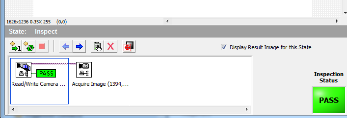

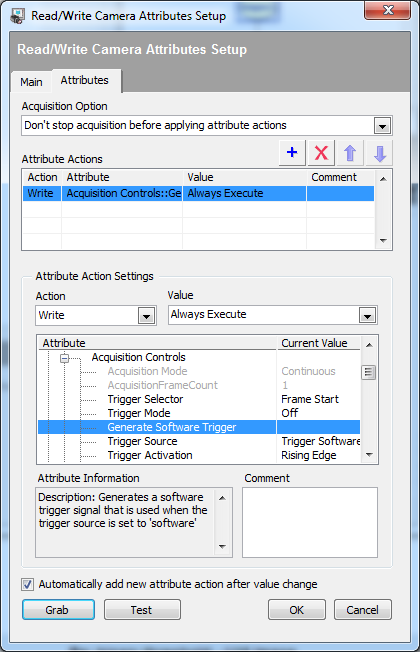

- Before the Acquire step, you need to fire the trigger. This is done via the Read/Write Camera Attribute step.
 * Add the step and then add an entry that executes the "Generate Software Trigger" attribute (there is no value to write since it is technically a command, not an attribute). I attached an image showing this.
Just make sure the trigger step happens right before the acquire step.

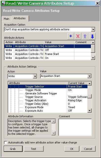

Thank you BlueCheese (Eric). Your comments were very helpful. I tried your suggestion, but it did not seem to work all the time. After reading the Basler Ace manual and doing a little experimenting, I discovered that putting the camera in trigger mode as you suggested must occur before each and every software trigger step. Also, it must explicitly turn "Aquisition Start" to Off.  I don't fully understand why it needs this extra config step before each trigger rather than only one time in Inspection Setup state.
I used a Read/Write Camera Attribute step to
  1. Set "Trigger Selector" to "Aquisition Start"
  2. Set "Trigger Mode" to "Off"
  3. Set "Trigger Selector" to "Frame Start"
  4. Set "Trigger Mode" to "On"
Since it works and doesn't appear to rob processing time (~ 2ms), I believe I have a valid solution.
