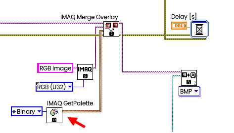

Its because your image displayed with Binary palette. It is Grayscale image, but you turn grays into colors by palette.
All what you need is to call IMAQ Get Palette with Binary and connect Palette input of IMAQ Merge Overlay as shown below, then it should work:
Message 4 of 8
(2,496 Views)
Perfect, that was exactly the problem!
