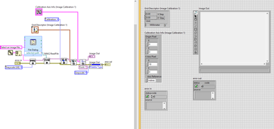

Ya i created that Calibration Image ..using vision assitant .
i can able to apply that calibration image to other vision assistant script also working.
Dont know how to use it in labview vi file ..
if i create vi file using vision assistant also shows calibration axis info and grid discripter as input ..
i dont know how to insert calibration image into vi file .. directly
Message 5 of 15
(6,392 Views)
Look at the calibration examples.  They should show how you load a calibration image and apply it to new images.  If you look at the calibration pallette in LV, it is pretty straightforward.
Bruce
Bruce Ammons
Ammons Engineering
Message 6 of 15
(6,388 Views)

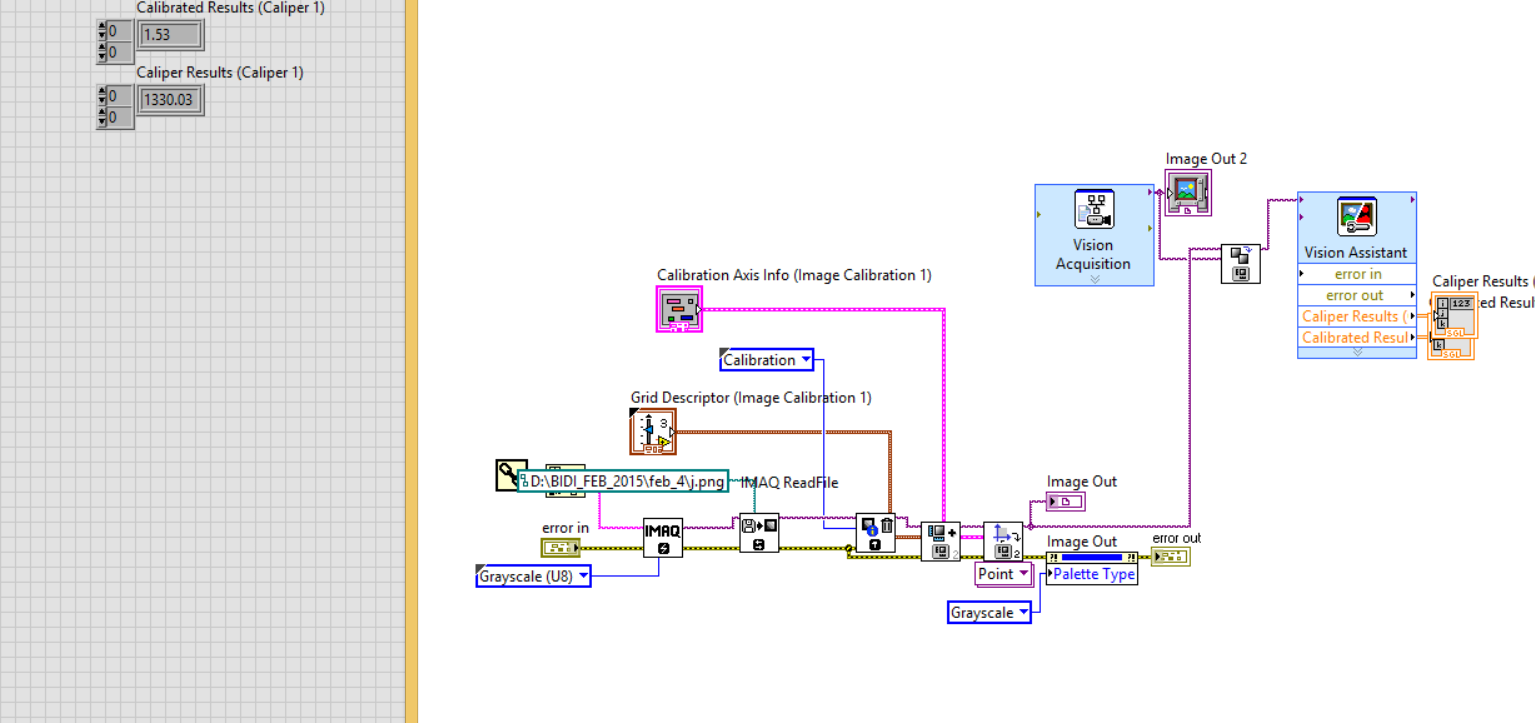

From this from this modificatioin i have added the calibration image
and i have done some caliper it gives calibrated value ..
am i doing correct ?
Message 7 of 15
(6,385 Views)
It looks right to me.  Do the results make sense to you?
Bruce
Bruce Ammons
Ammons Engineering
Message 8 of 15
(6,376 Views)
yes... it looks like correct ...

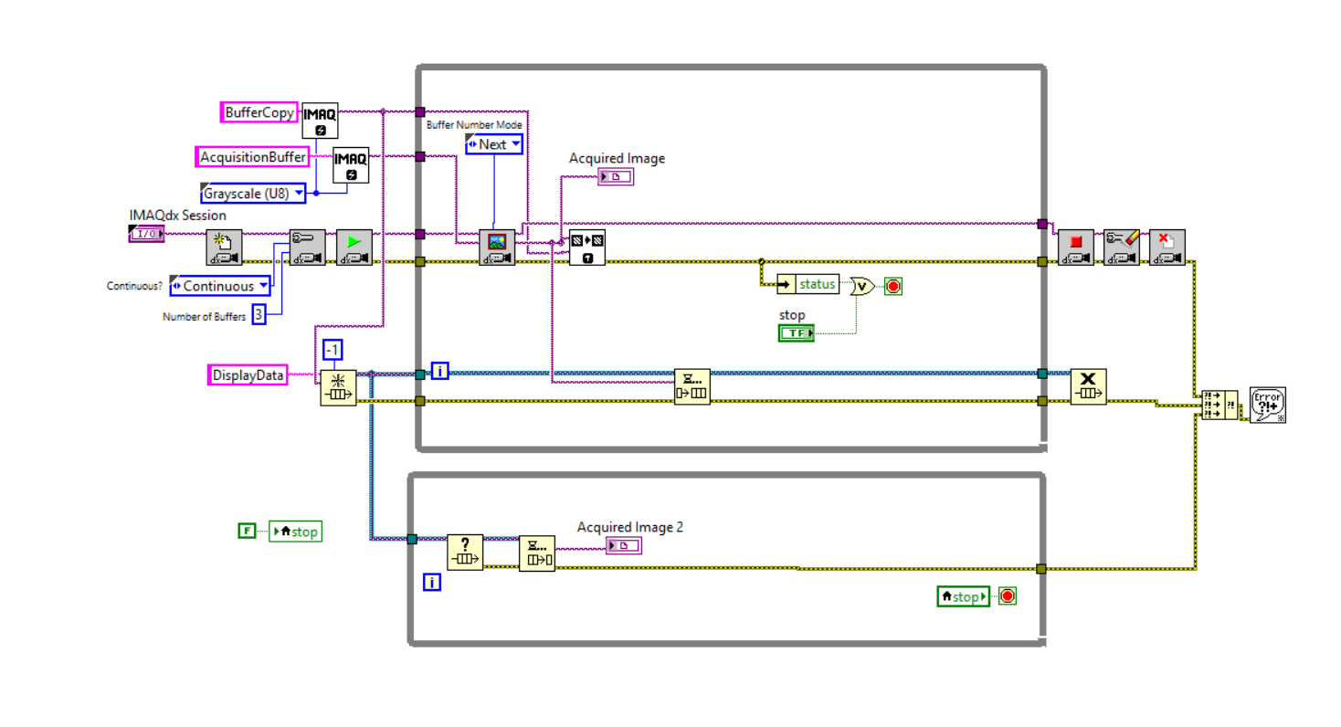

i am doing machine vision project .. in ni froum they asked me to use Producer and consumer loop for processing.
in this method i need to grab image continuosly
but i need process like
[move axis(motion control)]  - [ sanp image] - [ pattern match] - [ result]
Do you have any Design Pattern for this ?
