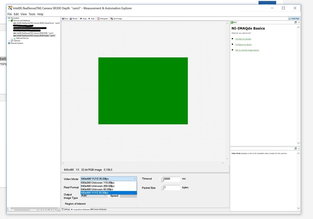

Hi Kashish,
I was wondering if you made any progress? I've come across your posts on multiple forums and unforgettably non seem to have resulted in success thus far.
I've hooked up a Intel RealSense SR300 and it shows up in Max as three separate camera's (see attached image)
The depth came shows the problem Kashish is describing, when using the YUY2 codec you get just a green screen. The other three video modes use codecs that are not supported.
I assume the structure is the same as the one that is recognized as YUY2, and only the frame rate is higher. But I have no idea about the data structure....
Tom

Unfortunately, you cannot access the 16-bit depth image of the RealSense camera using the IMAQdx driver. That only way to currently use the camera with LabVIEW would be to write a LabVIEW wrapper around the RealSense SDK functions.
-Jordan
