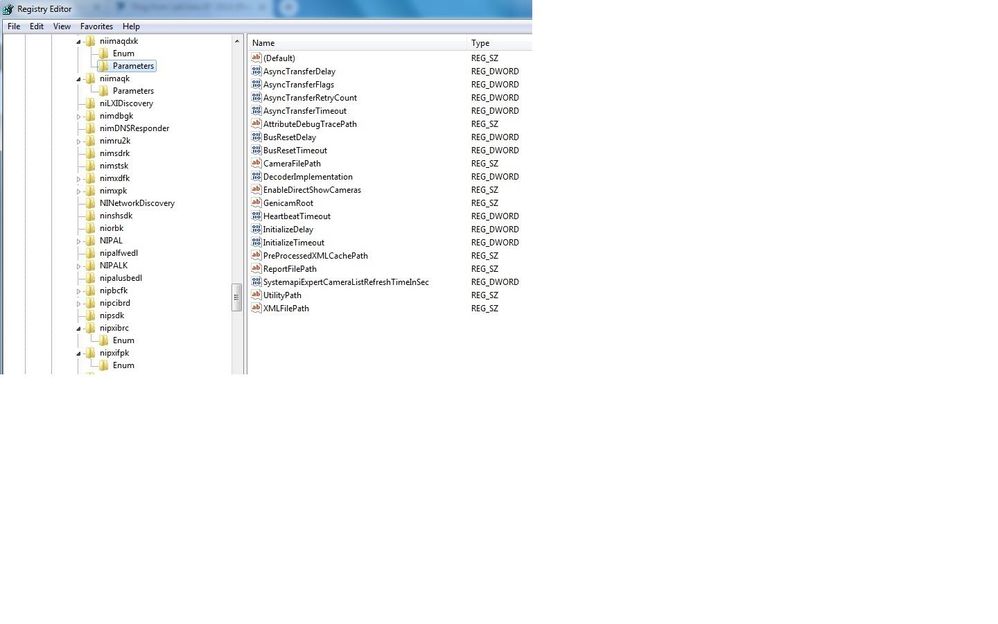

(4,489 Views)
As this is an old thread I don't know if you can still rely on this information.
However, if a registry key doesn't exist, you can create it ...
Message 8 of 8
