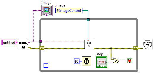

Accepted by topic author aricn
@aricn wrote:
BTW,
inside the subvi,  I pass the processed result to the property node vale or vale(signal), even I call the 'refresh display' metheod, neither have the effect.
Strange.
For example, this is your main VI (where Image Display is placed):

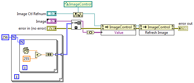

This is your SubVI, where Image Displays gets updated by reference:

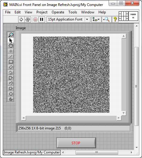

Now Image Display updated in Main.vi from SubVI:
Project (LV2012) in attachment.
Andrey.

Andrey and Klenmen, thanks very much for your great help.
Andrey's giving is just what i wanted, from your code i know HOW to do, i arrange the code like your block, and it works fine.
But more detailly WHY, i dot know, specially two fuctions, 'to more specific class' and 'to variant',
before i think the Image Out node could be linked directly to image control's 'Value' property node, it should be working, infact it not.
I will use this style afterwards.
