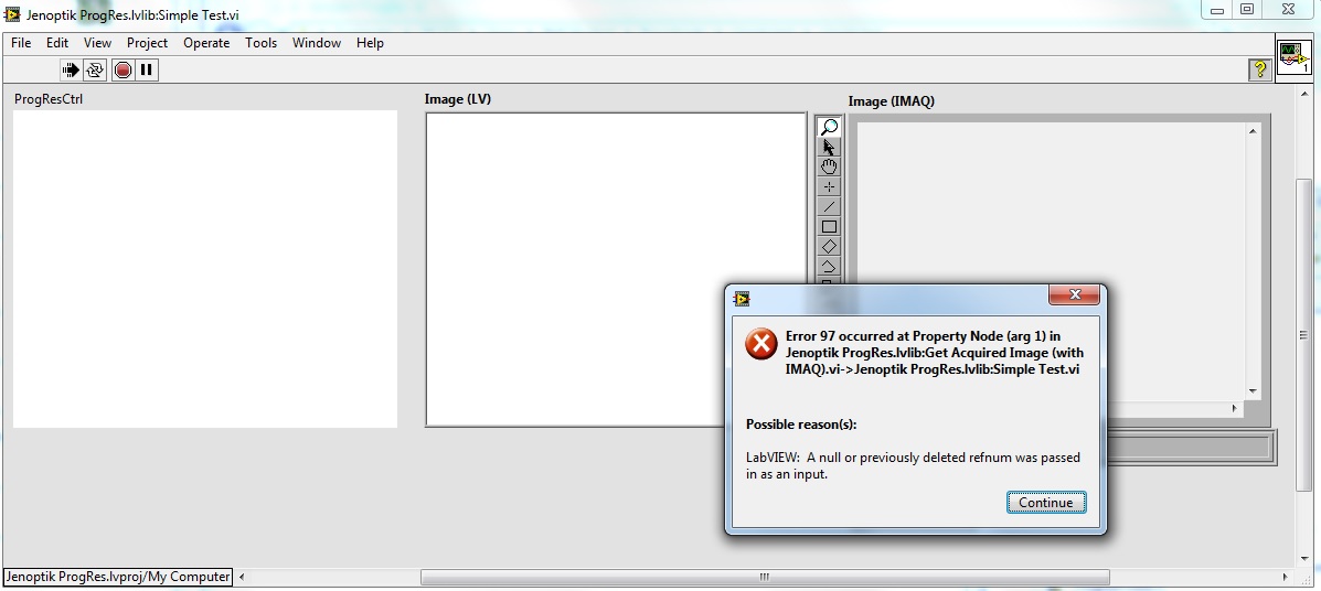

Hi
I added the files in my project and I started the example. Here is the error that I received:

Accepted by topic author tiho
Well,
what steps you've done for solving this error? Considering your previous experiences with Jenoptik API you should immediately find out that I forgot to connect the reference wire. You might be able to see it on the first sight. Try to think before asking...
Maybe you should consider to visit LabVIEW Core 1 and 2 classes first...

Thank you for your answer. It's working now.
