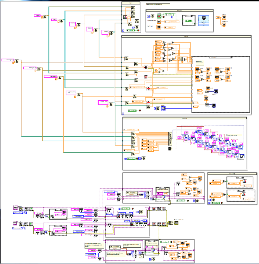

I have a largish VI that logs data from various sensors, and controls a few motors and actuators, through a pair of cDAQ 9174s and various modules. I write the results to a tdms file from a combination of queues and local variables. Below is a screenshot of my overall VI (from the navigation window), showing its 8 parallel loops:

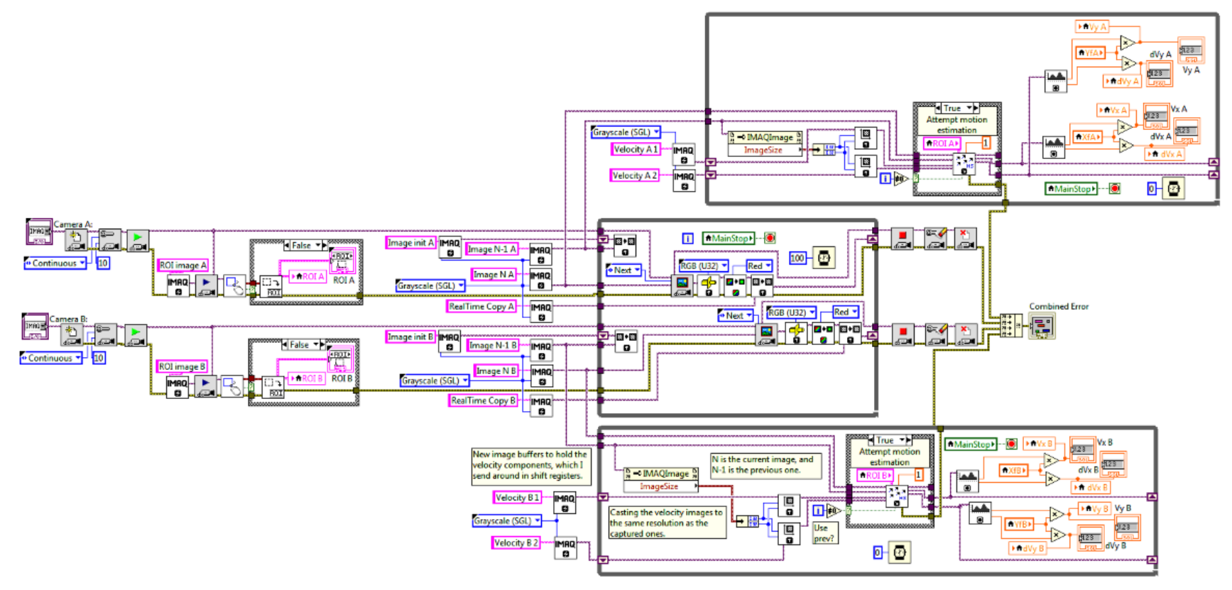

In addition to this, I have two USB webcams that I use to do motion estimation, using the IMAQ optical flow Horn and Schunck VI. Below is a screenshot of my motion estimation diagram:imageAnalysis.png
As you can see, I use IMAQdx to grab images from two different cameras. On first run, I obtain regions of interest for use in the Optical Flow (HS) VI. Thereafter, I get images from each stream, which I turn into black and white frames, and continuously update the current and previous images using a shift register. Then, for each pair of images, I force them to the same size in separate loops, and use IMAQ Optical Flow (HS) VIs to estimate the movement between them. Finally, I  store the mean and standard deviation of the velocities in each dimension in local variables to be logged in the TDMS.

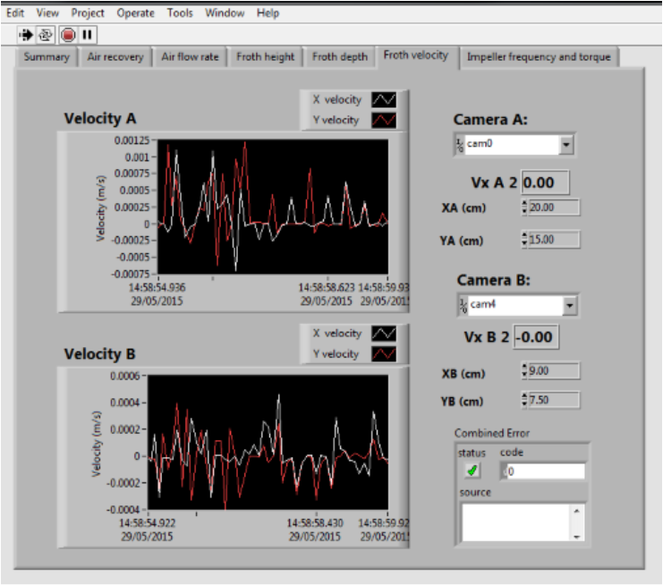

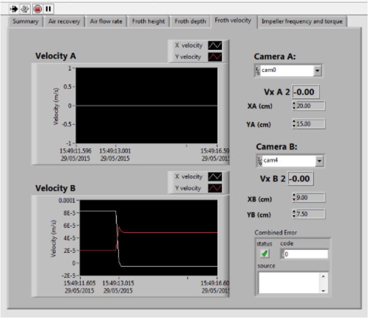

With all of that said, my problem is the following: Initially, the motion estimation seems to work perfectly. However, after between 5 and 10 minutes (although sometimes up to an hour or so), the motion estimation fails without producing an error. The image on the left below is the velocities chart with the motion estimation working correctly, and on the right is an example of failed motion estimation:
Sometimes the estimated velocity collapses down to zero, as it has in the upper chart above, and other times it enters an exponential slide-- resulting in velocities of the order 1e34 or 1E-38. Below are a few examples of the sort of spurious data that is produced when the motion estimation fails:
