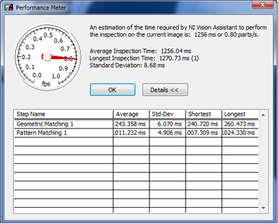

So, we can easily see that GM takes 466,414 ms (average)
than Pattern Matching must take 2111,39ms - 466,414ms = 1644,976ms (! not 651,227ms - average)
I measure in my program processing times, too. There is no way that PM takes under 1 sec.
I think it must be a CAR for performance meter formating, too.

Here are my performance numbers:
On your OS, the decimal point is represented with a comma, so I think that may be causing the confusion. My GPM takes 243ms and PM takes 1,011ms. The top level summary matches up closely with the sum of the individual step times. In your earlier post you said:
"Average values for:
Geometric Matching: 466,414 ms
Pattern Matching: (?) 651,227 ms
This can't be right, because if you read first lines: "An estimation of the time required by NI Vision Assistant to perform the inspection on the current image is: 2111 ms or 0,47 parts/s"
Average Inspection Time: 2111,39 ms"
 than Pattern Matching must take 2111,39ms - 466,414ms = 1644,976ms (! not 651,227ms - average)"
It looks like your PM take 1651.227 ms (the first 1 got cut off) and GPM takes 466.414ms, so that closely adds up to 2111.39ms or about 2 seconds. Just replace the comma with decimal points and I think this will clear up the confusion.
As for all the troubles you are having. I tried your two images again and your template and all 4 objects are found without problems using GPM in 243ms on my machine for both images. If this algorithm doesn't work for some of your images, please post those images and your template so we can investigate. Again, I would not recommend using the Low Discrepancy Sampling algorithm for PM for this image or the Feature Based algorithm for GPM, so if you use the GPM Edge Based algorithm or PM Pyramid based algorithm (although this can be much slower for large images where rotation is required) I think you will be much more successful. Please send us the images if these algorithms are not reliable for you.

Hello Brad,on your machine as a matter of fact takes GM about 1 sec.  (at least 4 times slower than GPM !)
About performance meter cell formatting: i wrote before that I thing there is a problem with performance meter formatting. We can only see there just 12 character. When a value over "999,999 ms" or "999.999" is , we see just this part.Cell widths are constant so man can't change the width . For example on screenshot an user can not see clearly if there is "1" left of the ".011.232 ms"
