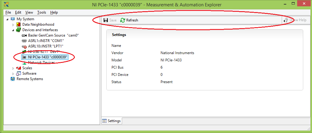

I have a PCIe 1433 installed and it worked fine for a year. However, since last week, the channel "img0" was disappear from the device list in MAX as shown in the attached figure.
The channel name is now list as "c0000039" instead of "img0", and there is no other menu except save and refresh on the right pane as shown in figure.
The labview based module, MAX, and the vision acquisition module is all 2014 version. I can locate the "img0.iid" file as well as the necessary camera file in my PC.

MAX screen shot

- I did try repair installation of Vision Acquisition and MAX. --> Nothing change
- I did try connect another working camera --> Same problem
- I put the frame grabber in another PC --> Same problem (exactly the same as shown in the previous picture)
