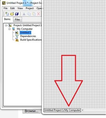

Is your VI set to run on an RT target by any chance?  Open the front panel and look at the bottom left corner.
Message 22 of 32
(2,320 Views)
No, I don't think so.
Message 23 of 32
(2,317 Views)
I do have the same file copied within my project to my CVS target like shown in the picture.
Message 24 of 32
(2,315 Views)
The dropdown box only shows cameras on the target set in the VI.  So the dropdown box for the CVS VI should only show cameras connected to the CVS.  The dropdown box in the "My Computer" VI should only show cameras connected to your local machine.  You can switch the VI target by clicking the box in the bottom left corner.
If this isn't the problem, I'm running low on ideas of why this isn't working for you.
Message 25 of 32
(2,309 Views)
No, I don't think that is it.  It is showing "My Computer" in the VI, but does not show the camera I am working with.  Thank you for your help.

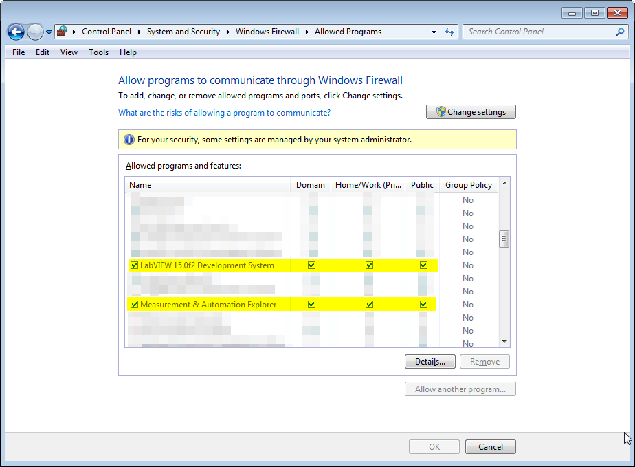

Could you check your firewall to see if you have given NI MAX and LabVIEW the same permissions?  Maybe try turning off/pausing your firewall to see if the behavior stays the same.
Could you also try accessing the camera via it's IP address in LabVIEW? "ip:<ip addr>" syntax to specify a camera instead of using the camera drop-down.
Clemens | Technical Support Engineer | National Instruments
Message 29 of 32
(2,258 Views)
The firewall was the issue.  My allowed programs had 2 listings for LabVIEW 15.0.1f1 Development System.  On one, the far left box was checked, and on the other, it wasn't, so I checked that one as well, and now my camera shows up on my dropdown box, and my program is running.  Thank you!
