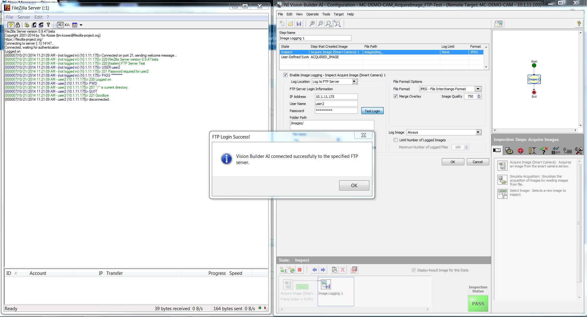

I'm using VBAI 2013 on an NI 1722 smart cam, I'm trying to save the acquired image to an FTP server (FileZilla on my PC).
The server works fine, I can connect to it from both my PC and my android phone and add/modify/delete files with the configured users.
Clicking the "Test Login" button from the "Image Logging" setup also returns a success popup message.
Problem is, when I run inspection, no images are saved and no errors are displayed. I don't know what's wrong.
Here I attached screenshots of what happens (I apologize if the pictures are too big):
BEFORE "Test Login"
AFTER "Test Login" (Notice FileZilla log)

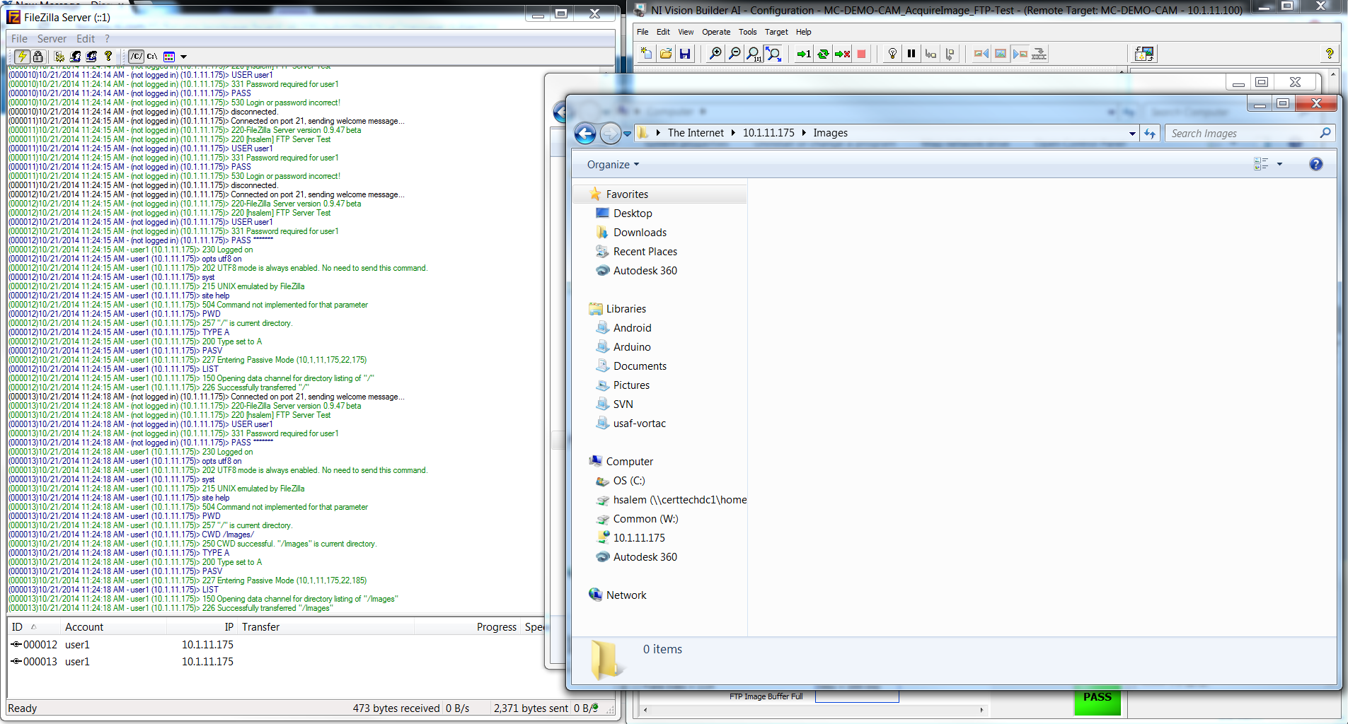

After running Inspection on Conitnuous mode for a few seconds (Image Logging step displays "FTP Image Buffer Full" error):

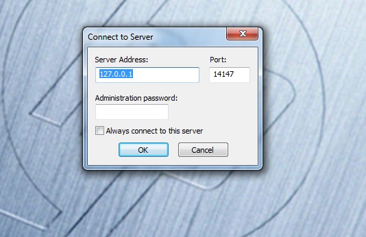

Its seems to be a port problem. I specified ports 21 (default) and 2000 to connect to the FileZilla server. I can connect from my Android phone via port 2000 but cannot connect with the default port 21.
However, VBAI does not have an option to change the port it connects to. Any solution?

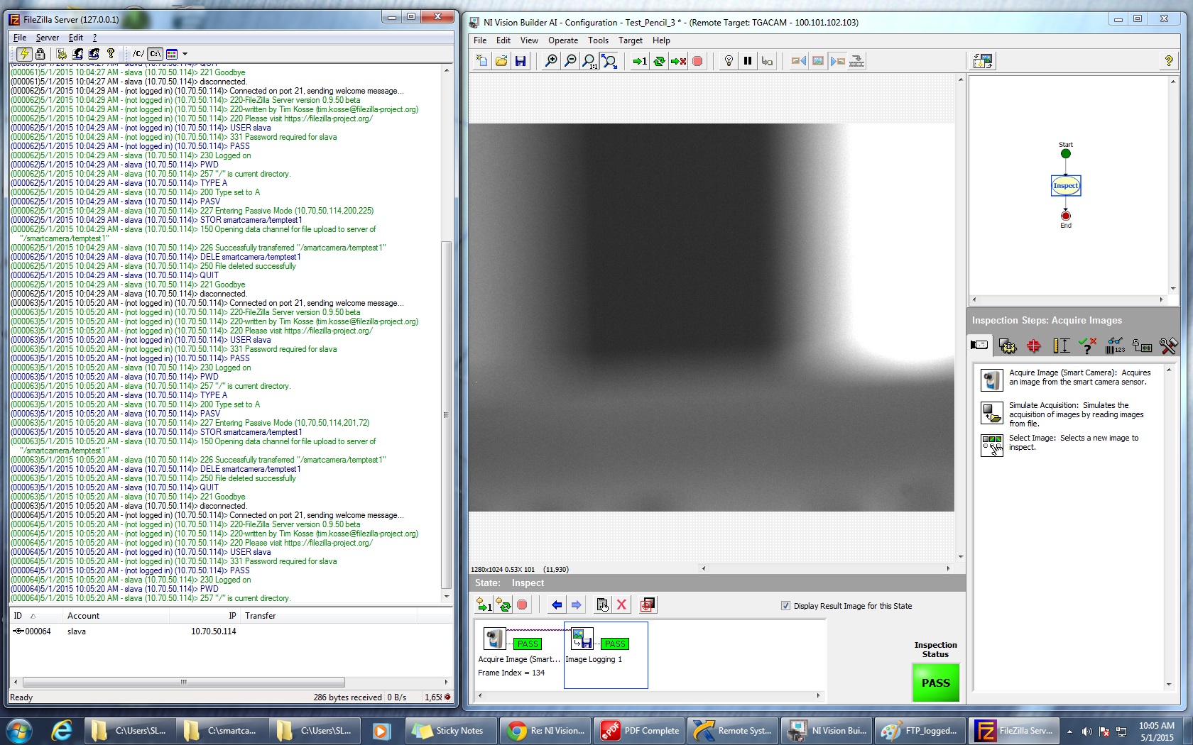

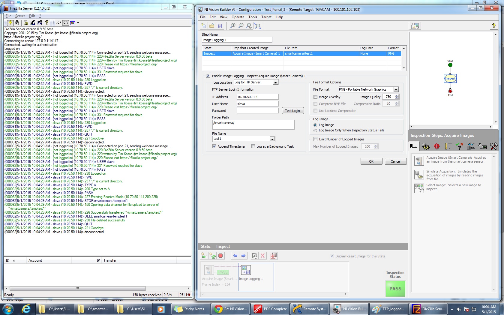

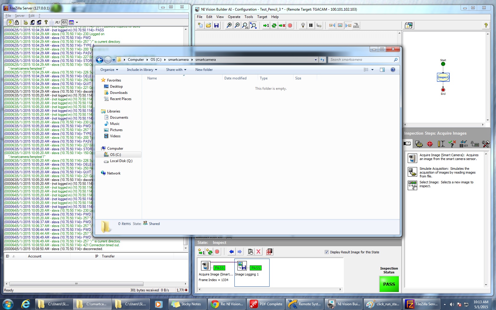

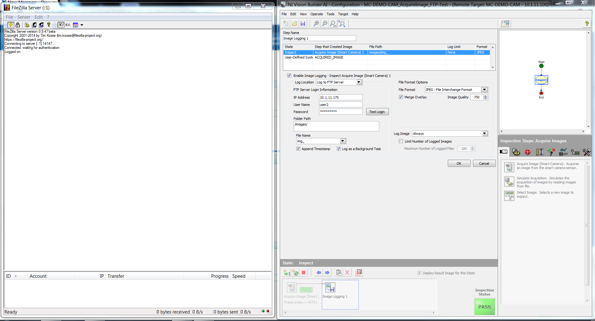

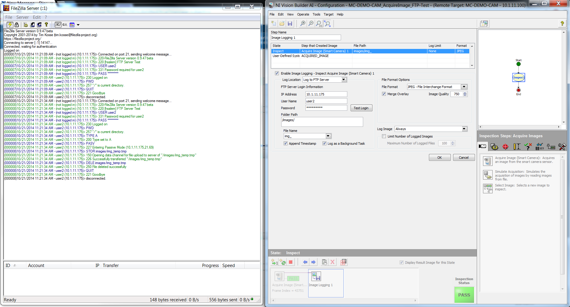

Brad, Thanks for your quick response. I actually changed the IP to the computer's IP. And run it again. Still Filezilla shows "disconnected" at the end. I am able to creat a folder through the logging setting but not save any pics. Please see the first print screen.
When I log in Filezilla, I only can use this loop IP and port is 14147. I tried to change the port to 14147, but it does not work.
I hope I have made myself clear enough. Please give me more detailed guidances.  I highly appreciate your advise. FTP_logging.jpg

It is expected that you get a message in FileZilla about Disconnected when you press the Test button. We just try ot login and save a sample file at the path you specified to ensure the login credentials are good and that the path is valid and writable, but then we close the connection once we have checked this out. So don't worry about the disconnected message. It would be more interesting to see the FileZilla log when you are actually running your inspection in Inspection mode (or you can use the top Run Button "Run Inspection Once" in Configuration mode). This will actually run the inspection on the target. If you press the bottom Run button "Run State Once" or "Run State in Loop", it doesn't run the inspection on the target, but locally and this can have different behavior. It looks like from your FileZilla log, it is using port 21, so you shouldn't need to change the default port used by VBAI.
So basically, try running the inspection and show us what the File Zilla log says.

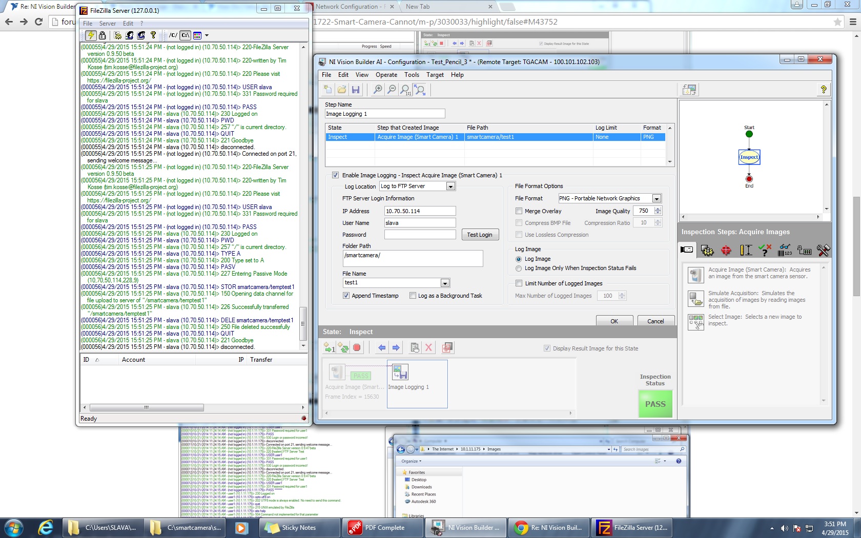

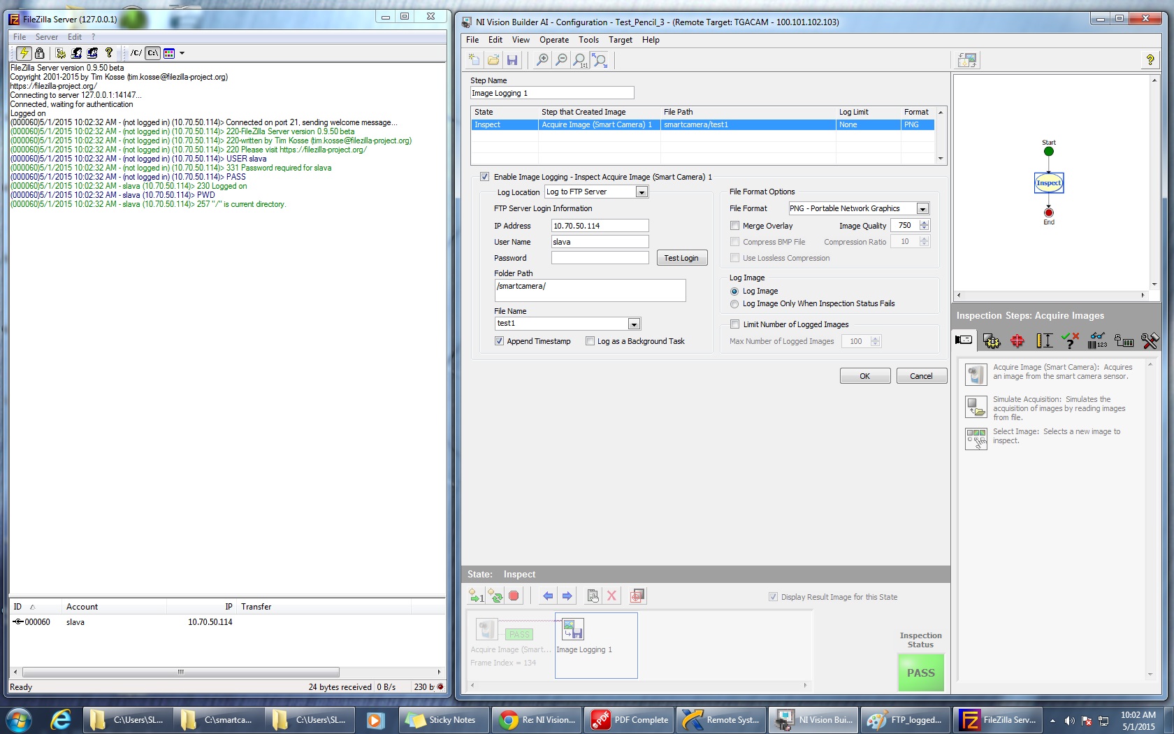

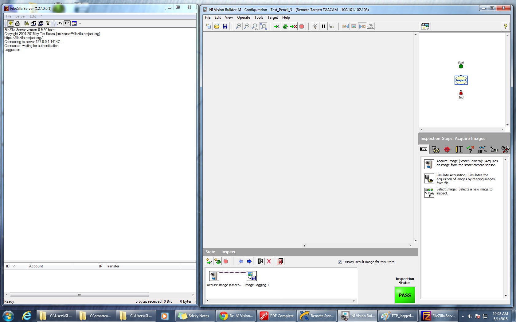

Thank Brad, I am showing you the step by step that how I set up FTP and test the "run state once". thanks for your help.
1. log in FTP server
2. FTP parellel with VBAI after logged on
3. Open image logging page
4. Test login
5. Click "OK" after test loggin
6. Run state once
7. the targeted folder is empty. No image is saved.

As I mentioned in my previous post, use the Run Inspection buttons at the top:
To make the Configuration mode more interactive, we don't actually save files unless you run using the top buttons. When you press the Run State, it doesn't actually deploy the inspection to the target and so there are some things that aren't actually run on the target.  You can also switch to Inspection Mode (Ctrl-I) and run and this will save your images.
Sorry for the confusion, hope this helps,
Brad
