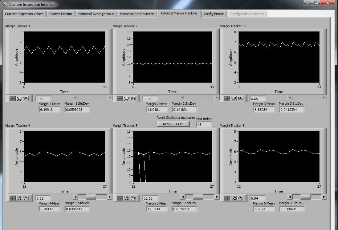

I am experiencing strange behaviour in Vision Builder stripcharts.
See attached Image.
You will notice that the three charts on the bottom are not updating or autoscaling.
If I leave and return to this tab the X-axis would update to [28,43].
Visible artifacts also creep in when the x-axis indexes past the chart edge.
I have deleted the charts and copied charts 1,2,3 to try and get the same bahaviour, but they always revert to the same.
I am running Vision Builder Auto Inspection 2010.
I would appreciate any suggestions,

Hi JCliffen,
Strip Charts show running data continuously scrolling from left to right across the chart with older data to the left and newer data to the right. So it makes sense that if this runs for awhile the x-axis range would have increased to [28, 43]. Also, could you elaborate a bit on what you mean by visible artifacts creeping in?

The first 3 charts always show the X-axis from 0 to (Xmax).  And will update to show 0 to Xmax+1 on each UI update.
The last 3 only show a subset of the x-axis and never updates the x-axis unless you switch away from the Tab it resides on.
The artifact I am seeing is shown best in Margin Tracker 5.
There are multiple overlapping lines that do not match the incoming data. Data value is only 12-13.
All stripcharts are single plots.
I am hoping someone has seen this before and solved it.
