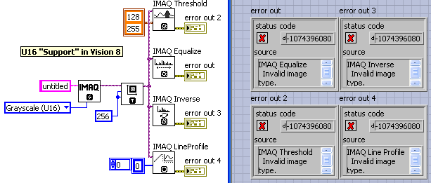

Evan, before this recommendation try use U16 yourself. Well, U16 was introduced in Vision 8.x. But this type is unusable, because only few processing algorithms support this type. Technically you can create U16 now, but you can't do much with it:
Is this U16 support?!
