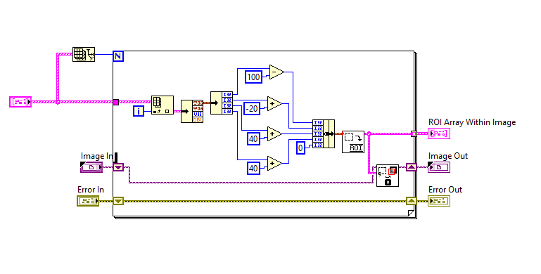

I tried to look for shape matching examples for these kind of projects. I managed to find this. This program converts the Shape Report from the IMAQ Shape Matching VI into ROI image. This works for my program but I don't understand why substracts and adds the numbers (100, -20, 40, 40). If I can understand this maybe I can improve my program further. Thanks.

These four numbers of the shape report are x, y coordinates of top left point and bottom right point respectively. I do not know what is the original VI but those calculations are made based on the needs of original VI. In your case, you need to look at the inside of the rectangle so you can directly use those coordinates. Or you can also make some calculations to only search at the inner part of the rectangle, ignoring the frame.
