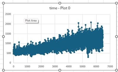

I'm post processing a bunch of images.  Basically converting gray scale to binary and identifying a range of features and reporting out to a spreadsheet.
As the number of images processed increases, so does the processing time.
Below is a graph with the number of images processed in the X axis, and the time for each process in mS in the Y
Note that the variation in processing times becomes wider on top of a general time of average time increasing.
Image complexity is not a factor, running the data set back to front yields the same result.  The reporting module is turned off, so no results are being saved except the graph monitoring progress.
I'm open to suggestions on what to look for in the program to get a repeatable predictable time outcome.
