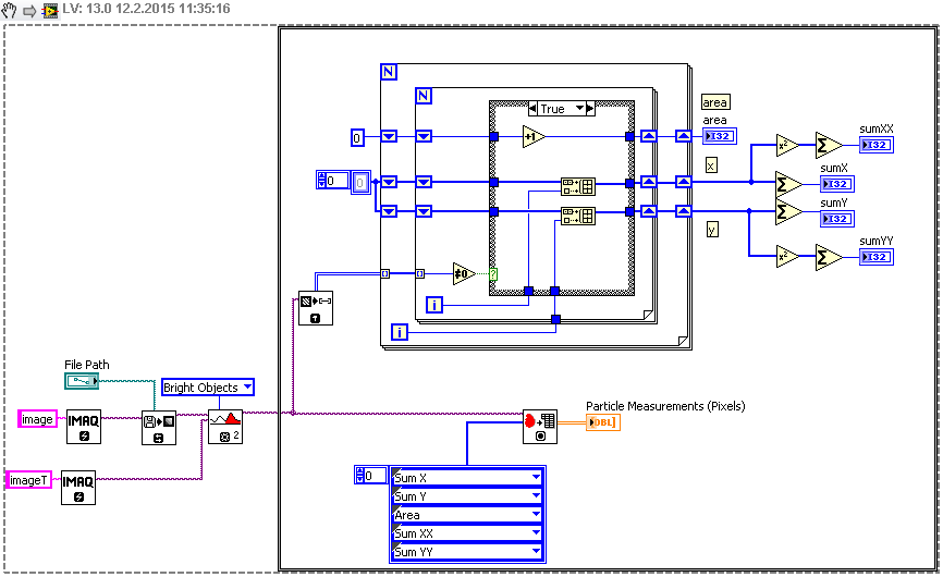

they are calculated as is shown by the equations you've provided.
A hint:

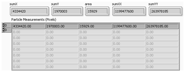

Hi Klemen,
Thanks for your insights. The vi helped me to understand the calculations performed to obtain the sums and moment of inertia.
Also I composed a small vi of my own which helped me to understand a little further.
I am attaching it with this post.
I have summarized my learning in the comment of the vi.
