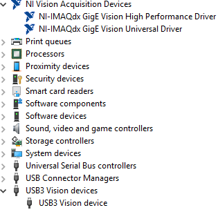

This is what is displayed in Device Manager for the Pleora USB3 hardware.

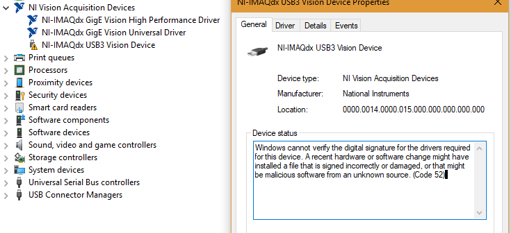

When I uninstalled the Pleora USB3 Vision Driver and tried to install the NI-IMAQdx USB3 Vision Driver, it gives an error due because the digital signature cannot be verified.

Accepted by topic author SWIR_cameras
There was a known issue with VAS 17.0 on Windows 10 that throws this error. If you install Vision Acquisition Software 17.5 or later, the error should go away.
