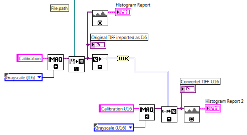

I then tried to open the files as I16 and convert to U16 with this code:

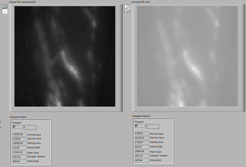

This seems to work ok for some files, but not all (Same sequence recorded with same settings). When I run the code for “Picture 1” it looks like this:

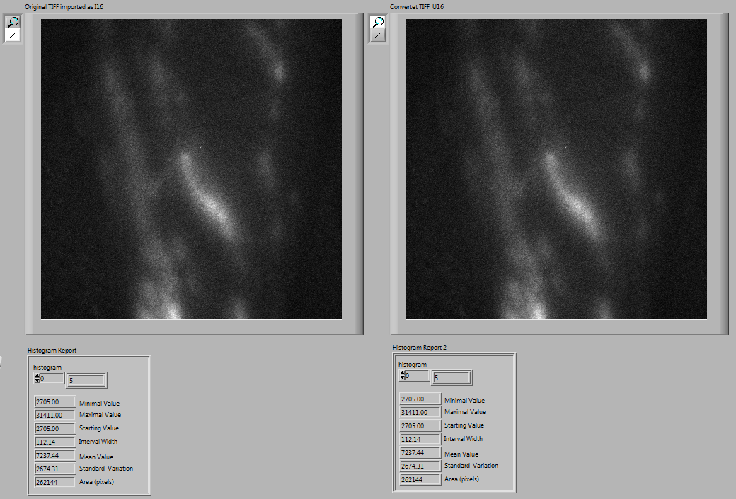

When I run the code for “Picture 2” is look ok:

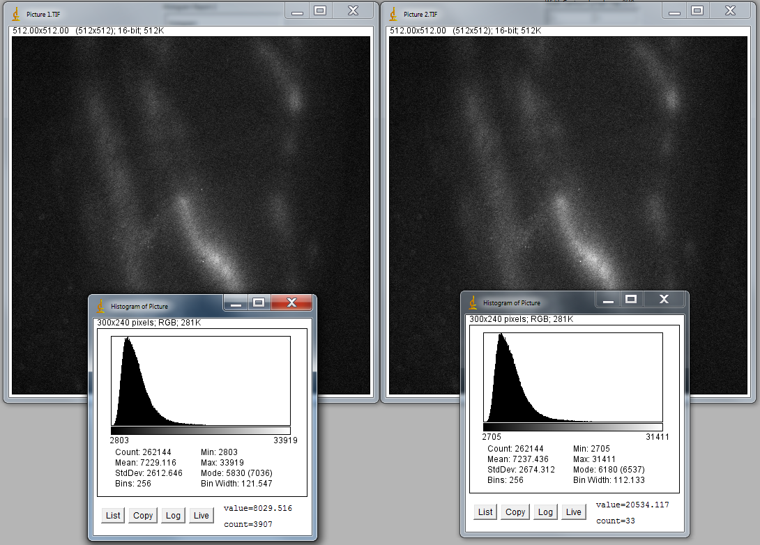

And just to mess everything up, when I open the to TIFF files in ImageJ and draw a histogram I get this:
The “Picture 1” to the left look perfectly normal and notice the mean pixel value I almost the same (as expected with pictures recorded at 1 second interval).

What springs infront of my eye is the minumum and maximum values in the 2 images you have chosen.
So Picture 1 does actually have negative values while picture 2 does not. So the conversion is not working, you are just only seeing the affect of the conversion not working on the first picture because that one is only having negavive values.
Notice for Picture 1 you are changing the maximum value from 1736 to 62156 (so you scale it to the new data type) while for the second image you don't do that the image size is still the same. So it looks to me that LabVIEW sees image 2 as a U16 while image 1 is seen as I16. I think it has to do with what is in the headfile of the TIFF image. I believe for these 2 images there must be a difference in the header file that LabVIEW use and Windows file viewer and ImageJ does not.

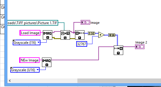

I tried to do the conversion manually like this and it seems to work pretty good.
Let me know how this works for you.

Hi Anders
The solution you gave me seems to work just fine!
I have a small difference in pixel mean values between the ImageJ histogram and the converted (I16-I32-U16) TIFF files, but I guess it is due to the conversion(s).

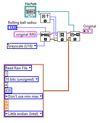

I had the same issue too and the Anders code worked only partially. In many cases i had pretty weird conversion especially if i had areas close to saturation in the images. (eg below)
What i did as a workaround  is to read the images as raw files since i know what i've taken.
Note the offset to be used. I think it is file dependent.
Hope this helps.
