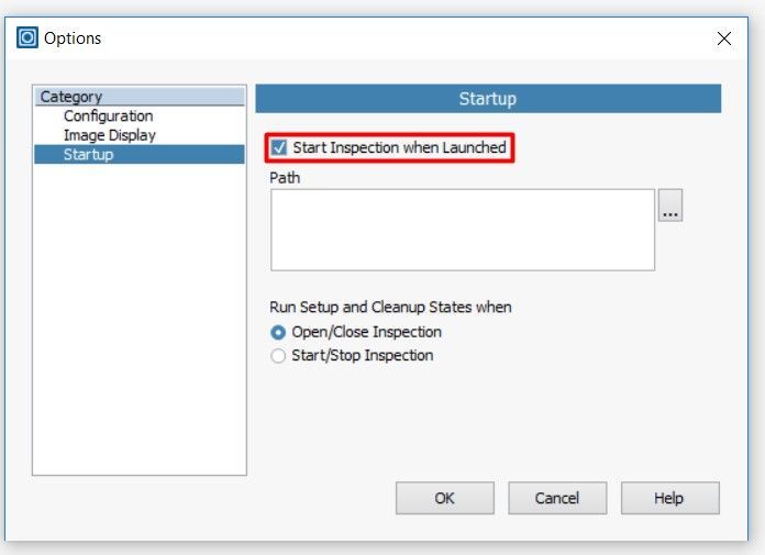

When running Vision Builder AI on your desktop, open Tools>>Options and select the Startup Category. You can select to launch an inspection automatically when Vision Builder AI launches.
If you target a CVS with Vision Builder AI, open Tools>>Remote Target Options and select the Startup Category. This way, you can select to launch an inspection automatically when Vision Builder AI launches on the Compact Vision System.
You can also use the Switch Inspection step to change the inspection files on the fly.

Dear Alejandro Balma,
I have selected INSP1 in startup.
I use the Switch Inspection step to change the inspection files during inspection. I need to replace inspection file in startup to new inspection file when "Switch Inspection step" is done.
