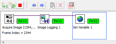

Hi all. i am using vision builder .
Here my application will acquire image (GigE) and store it to particular location .
Once i do continuous run the CPU usage become above 50%.

Brad's suggestions were good ones. Try adding a Delay step with a 1ms delay.

Hi Brad , ChristopheC,
your Suggetstion helped me .
What i did it is .
Insided of continus acquire image i did snapshot .
then i added delay step .. it gives some effort. thanks .
