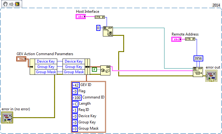

I have Basler ace with new fw which supports Action Commands. There is an example how to send it from Basler Pylon SDK. But do you know the way how to send it from LabVIEW?

Native support in the API is not present today besides when using hardware like the PCIe-8237R or CVS-1458RT which sends the Action Commands in hardware. Fortunately since these commands are meant to be sent by anyone on the network, it is trivial to just send them via UDP directly from LV code. See the attached VI for an example. Note that there are some optimizations missing like re-using the socket for multiple uses. Additionally, on some platforms, you may need to iterate through all host IP interfaces to send a packet out through each of them.
