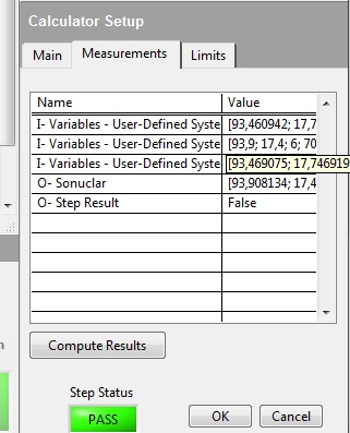

- When I deal with arrays in VBAI, on the calculator step, I can not see the results of all element calculations under the measurements tab. Only a few of them are visible, and there is no way to scroll left-right to see others.

sevincom,
Your first question regarding the number of visible elements in the array cannot be changed. I was unable to find a method to display different array elements or expand the number that are shown.

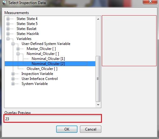

Thank you for your response.
Below image can explain what I mean better. I create a numeric 1D array, where the elements are fractional. But I can not overlay them as fractional or other formats in the custom overlay step. It is only possible as integer number. I tried this with creating the array as system variable, inspection variable and the result is same for both.
(6,464 Views)
Accepted by topic author sevincom
I'm seeing the same behavior on my end with numeric arrays. I want to play with it some more, but I will likely be filling a CAR for this.
As a workaround, you can convert the numeric array to a string array. It seems string arrays display the decimal portions correctly after conversion. I would suggest using the Number to Fractional String function, located in String->String/Number Conversion. This will let you input a 1D array of DBLs and specify the precision.
(6,454 Views)
Thank you. I think it works fine for the overlay function.
I hope there will be some improvement about expanding visible array elements in the calculator step Smiley Happy

I created an action item to fix the Overlay step not displaying the formatting options for numerics when they are a 1D Numeric Variable.
I also created an action item to use a tree for displaying the results of the Calculator and Run LabVIEW so you can see all the results for an array if you expand the array parent item.
You can also go to Tools>>View Measurements to view all the results for the inspection.
