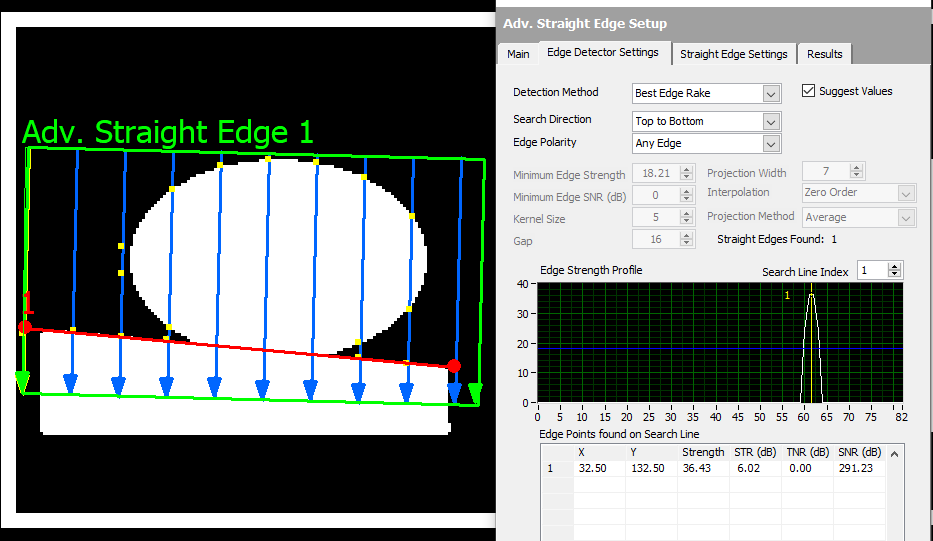

Hello Jujian
You can fit a line(rectangle can be inclined anyways) and determine where exactly the rectangle lies (top or bottom of the circle - use centre of mass), then you can mask and extract whatever you want. Like this
Always try to attach the actual data rather than the sample. Hope this helps !
-Rahul

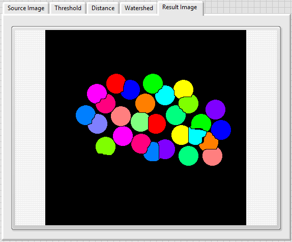

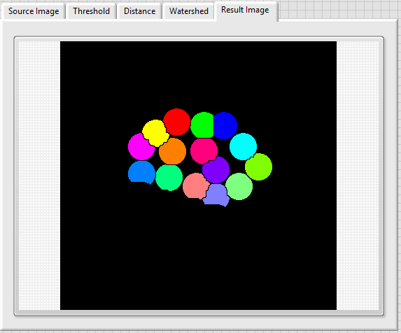

I slightly modified the Morphological Segmentation example and got it to remove the bar that the circles rest against, below are screenshots of the segmentation.
The only changes to the example are:
 - Changed the initial threshold to search for dark objects instead of bright
 - Added a Particle Filter after the IMAQ AND, to remove particles that aren't circular
Attached is the modified VI, saved for LV2018.
