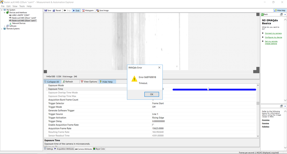

I have 2 basler aca1440-220um camera when running for 4 5 hours then this error. I reset the program, this error appears continuously, I went into Max to run the same error. I am using win 10, cab usb 3.0Capture.PNGn10, usb3.0 cable

You might want to try tweaking some of the power saving settings as mentioned in this post. Ensure that you are using a recommended USB3 host controller (Intel or Renesas) and a quality USB3 cable (without a hub) that is 5m or less in length for optimal reliability.
