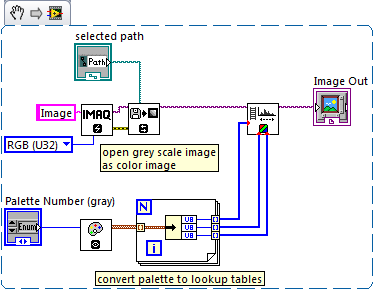

Looks like it works, but it is a bit complicated.  I was thinking something a little simpler, like this:
This just converts the palette to color lookup tables and uses the color lookup vi to convert the image.
Bruce
