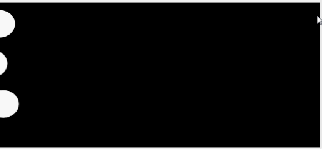

Below is the example of object ID labeling, assuming that the object detection is already performed in the previous step. It will assign a new ID for each new object and keep the ID throughout the field of view of camera. The ID labeling is based on minimum Euclidean distance of object's centers between two successive frames.
The only problem is when the object goes out of field of view of the camera. The labeling is then incorrect (this can of course be modified).
Tell me if this helps and I can attach the example code.
P.S.: The process takes ~12 ms per frame on my computer (includes reading the 11 images (~500x200 resolution) shown in the animation).
