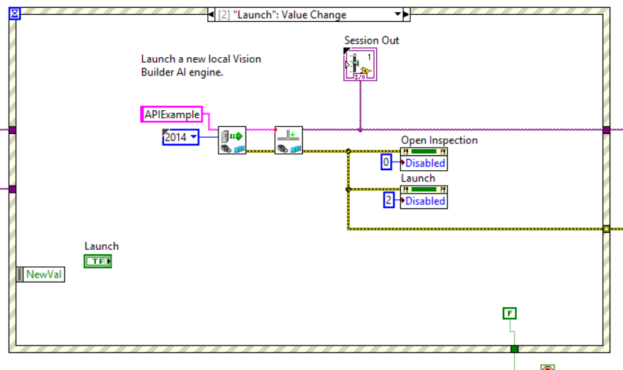

Check out the VBAI API you can use from LabVIEW to launch multiple local VBAI engines or connect to multiple remote VBAI engines. The example illustratews how to use one (there's an example for a local engine and remote engine), but it should be easy to expand the scope to use multiple engines.
<National Instruments>\Vision Builder\API Examples\LabVIEW Examples

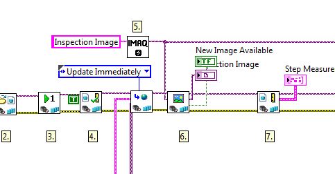

If you check out the example here:
C:\Program Files (x86)\National Instruments\Vision Builder AI <version>\API Examples\LabVIEW Examples\LabVIEW API Example (Local).vi
It will show you how to use the VBAI API in LV to launch a local engine, open an inspection, run it, get the resulting image and results. You can use the Enable Measurements VI and Get Measurements if you need more detailed results from the steps in VBAI. Read the documentation on all the VIs in the VBAI palette of LabVIEW to better understand how to use these VIs to accomplish your goal. Press Ctrl-H and hover over any of the VIs to get help and then you can click on the Detailed Help link, or check out C:\Program Files (x86)\National Instruments\LabVIEW <version>\help\VBAI_LV_API.chm

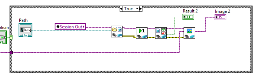

i am using this method to Call different vbai files .
but VBAI file opening. takes so long .
in that case

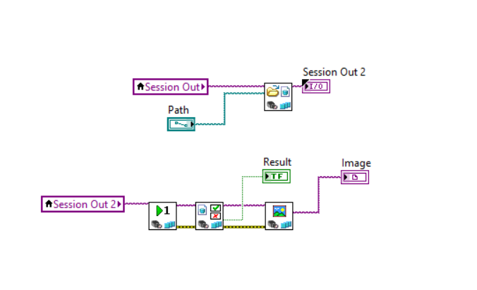

I tried following method
Its Working Fine . But not able to Open multiple files.
So please give some method to open multiple files .

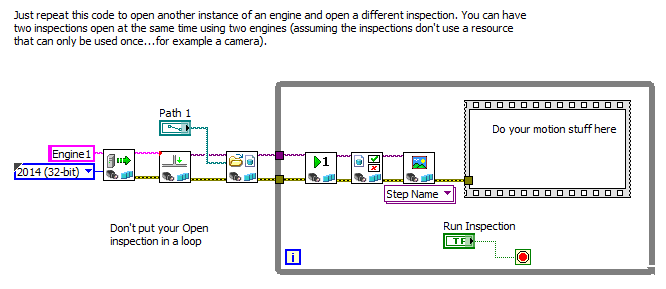

If you don't need your motion stuff to be synchronized with the VBAI inspection (i.e. just get the latest results from VBAI, but let it run as fast as possible), use the VBAI Start Inspection VI outside the loop instead of the Run Once VI inside the loop.
