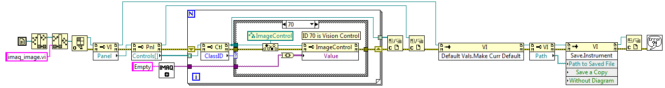

Another possible way is to automate this task, something like this:
Just obtain list of VIs where Vision Control should be resetted to default, then run snippet above in the cycle.
Andrey.

Thanks Andrey for the code!
