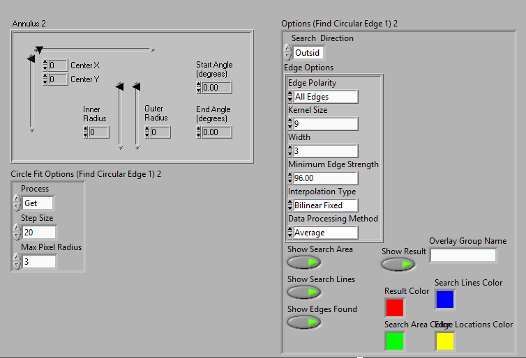

saving changes in circle finder input settings
In Circle finder and Pattern matching
we are using some ROI and input setings ..
i need to save this changes while applcation running itself.
Which method i have to use ..
to save the changes

use xml with event based structure to read and write the selected values.
Xml example (you can write the the circular detection options datastructure directly):
