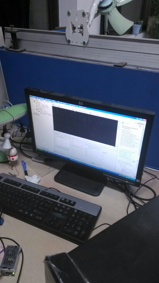

   this is the first time i used the basler spl 2048-140km camera.The camera without lens get an image as follows.is the image is right?why there have many white lines int the image?58C4179206FC2EB382DA6ED5D3F8C9B1.jpg

A screen capture would be much more helpful.  Press the PrintScreen button on your keyboard, then paste it into your favorite photo editor.  The picture of your monitor from an angle is not legible.
My initial guess would be that the camera is not configured correctly.  I think this is a two tap sequential camera (my spl2048-70km is).
Can you point the camera at a light and get all white?  Can you cover the sensor and get all black?  Those are good starting points for diagnosis.

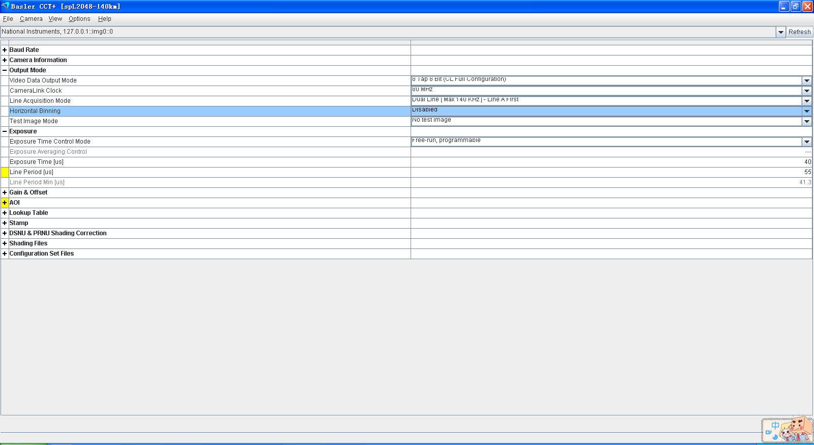

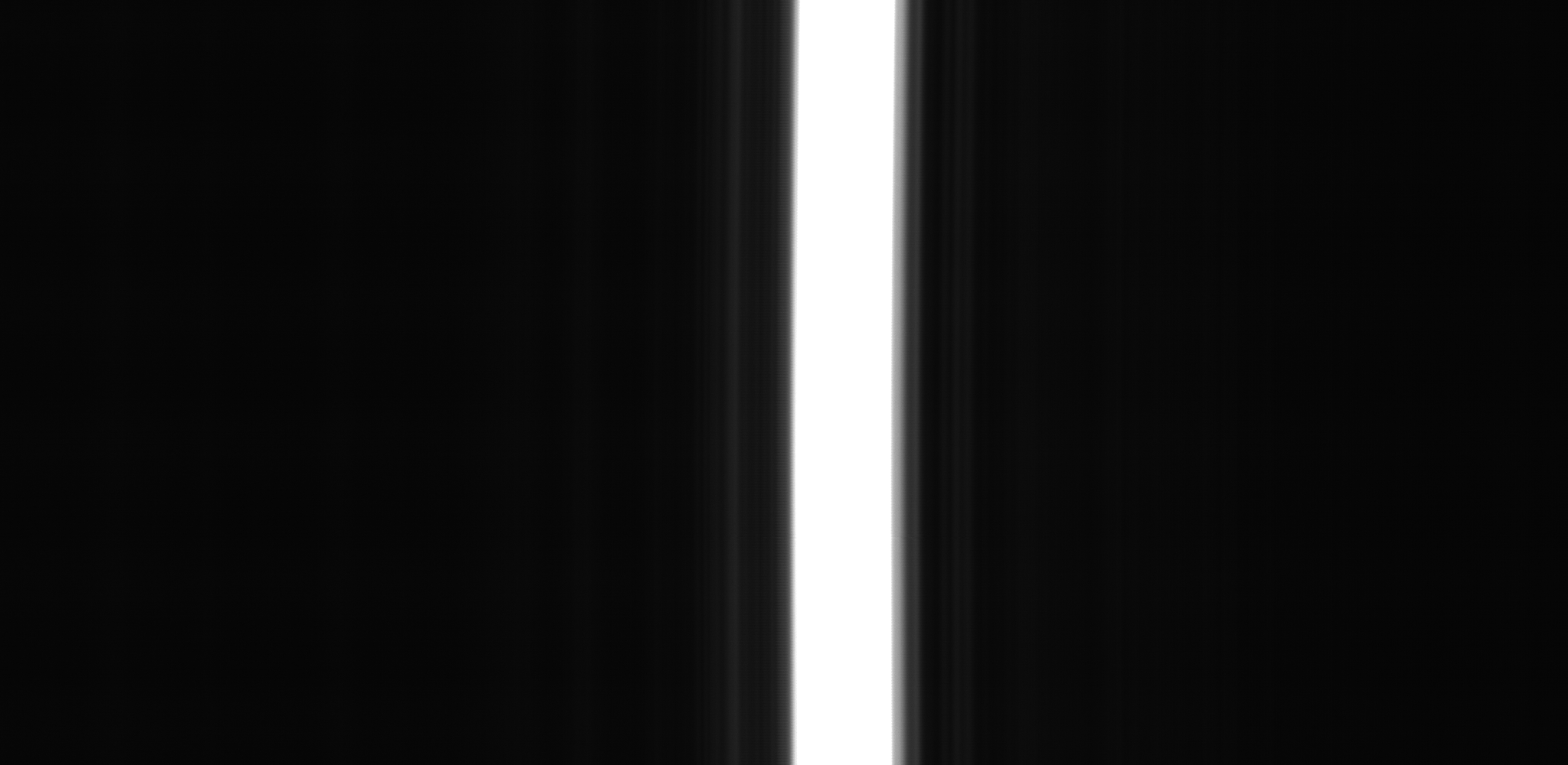

thank you for reply! this is my image i accquired and configuration tablQQ截图20140626221714.pngQQ截图20140626221750.pnge .Are there any problems with them?
Message 8 of 12
(6,660 Views)
I can't read the details for the tap setup, but it looks like 6 or 8 taps.  I would guess the camera has 4 taps at most, so it would be inserting blank data between your good data.  That would give you stripes.
Read the camera manual and figure out how many taps you should have.
Did you start with an NI configuration file for this camera, or did you adapt it from another camera?
Bruce
Bruce Ammons
Ammons Engineering
Message 9 of 12
(6,655 Views)
OK,Thank you! The camera data output mode is 8tap 8bits.The latter image is better than the foremer.
