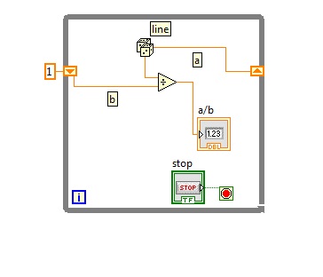

you need just use shift register for this one
see this image and do it for your line lengh wire  data

Accepted by topic author wajih7
this is two method for your request one with holding ctrl and plot two line roi
second without use ctrl for line
see two of them and choose with is better for you
