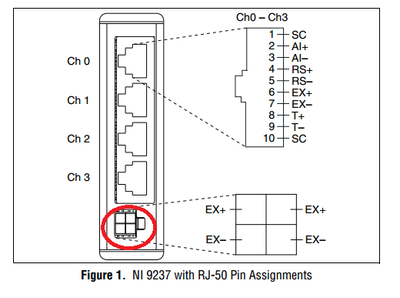

There are 2 optionsthat could help you to solve this problem:
  1. Replacing the module with a DSUB module but, of course I know this isn't a good solution.
  2. Use the Auxiliary (additional) excitation connector of 9237 for the excitation pins instead of the RJ50 EX+/- connections.
Explanation for the 2. option:
The EX +/- pins on the AUX connector of the 9237 module (under ch3) have a direct short to each of the EX +/- pins in the RJ-50 connectors.
So you can just wire the excitation directly to the strain gauge from the AUX connector and still use internal excitation as normal.
To connect to the auxiliary excitation connector you will require a NI-9942 4-Position Micro-Fit Plug and Terminal Kit
Please try my suggestions, and post the results.

So if I understood you right (i'm gonna try this solusion on half bridge) I need to disconnect the EX+ pin on 9949 adapter (which goes direct to strain gage, in my case it is pin6 if I follow the half bridge connection diagram) and connect EX+ cable from strain gage directly to Auxiliary excitation connector pin EX+.

"connect EX+ cable from strain gage directly to Auxiliary excitation connector pin EX+." => Exactly. You have to connect excitation dricetly from the 9237 AUX EX+ to the strain gage.

"connect excitation directly from the 9237 AUX EX+ to the strain gage." -> OK i have done this, but still i haven't solve the drift problem.. I isolated the 6th pin on RJ50 cable (the EX+ pin) and connected the EX+ cable from strain gage to 9237 AUX EX+.

Due to this https://www.ni.com/en-us/shop/model/ni-9237.html no external power or excitation is needed because the USB-9237 is bus-powered and has built-in excitation of up to 10 V for the connected sensors.
To make it clear, in the previous posts I recommended to connect the excitation pins of the strain gage directly to the AUX excitation pins of the 9237, because the 4 pin connector has direct pass through from to the EX +/- pins on each channel, even by using internal excitation. So if you set 5V excitation voltage, you can measure it on pins 6 and 7 and on the 4 pin connector too. Using the 4 pin connector to connect the ex. voltage on a strain gage directly, eliminated value drift in a previous case, because drift was caused by varying cable impedance when the RJ-50 cable is disturbed.
