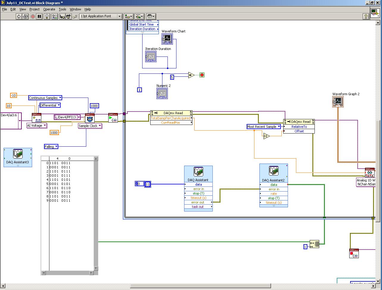

I am pretty new to labview and I wanted to measure 7 analog channels at once. The problem is that when I measure each channel seperately, I get different result than when I measure them all at once. I read about ghosting and created a unity-gain-buffer using an op-amp to lower the source impedance. However, it hasn't helped much.
I was wondering if I am doing something that I am not supposed to do.
Below is my labview program. I used clock 1 (digital pulse waveform) to generate a clock. According to this clock 1, an 8-bit digital waveform is generated. I am using the most significant bit of this 8-bit digital waveform as clock 2 which is used to sample the analog input waveform. The series of 8-bit digital waveform is the array of 10 numbers in the picture. I am feeding clock 1 which is generated from PFI 12 and PFI 15 is reading this clock and using it to generate the 8-bit signals. I am using USB 6251 to do this.
The weird thing is that when I use oscilloscope to check the data that I am measuring, I see a peaking in my data and this peaking occurs exactly when the clock 1 goes high. However, clock 1 is only connected to PFI 15 and is isolated from the circuit I am measuring. Now I am wondering if there's a crosstalk inside DAQ box.
My first question is whether I can use a clock to generate 8 bit signal and use one bit of this 8-bit signal as a clock to sample data. The second thing is how do I make sure that what I sample from DAQ box is really what's happening inside the circuit. It seems weird that when I sample 7 channels at once, it gives me different values than when I sample only a single channel. Again, I've used unity-gain-buffer to try to remove the ghosting effect. I am sampling at a period of 400 microsecond.

when you test the 7 analog channels in Measurement and Automation Explorer (MAX) do you still get different readings? open up test panels in max and test for each ai channel, then compare with acquiring from all (try without the op-amp first).
