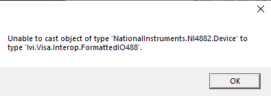

I'm trying to convert / add code (in VB.NET) to control but GPIB and USB devices using Keysight's VISA drivers. I've been able to get either the GPIB or USB versions to work but not merged. I also received this error which I was hoping someone could give me some insight on.
'Unable to case object of type 'NationalInstruments.NI4882.Device' to type 'Ivi.Visa.Interop.FormattedIO488'.

Found the problem.
I was mixing up VNA.Writestring with GPIBDevice.Write and vise versa.
