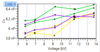

When my displayed data change during runtime, the axis (numeric) labels of the graphs within the active TabItem are updated correctly, but the axis labels of the graphs within the inactive TabItem stay as they were before - only the display, because when I click on the max/min-values of the axis, the right values are there. I attached a screenshot of this behaviour for better understanding:

It looks like your problem is due to the same underlying issue as the “incorrect x axis” question, where the scales do not get updated when the graph is in an inactive tab and unloaded. To workaround the issue, you can use this Loaded event handler to manually refresh the scales whenever a tab is activated:
private void OnGraphLoaded( object sender, RoutedEventArgs e ) {
    var graph = (LayeredGraph)sender;
    foreach( IScale scale in graph.AllScales )
        scale.OnInvalidated( new PropertyChangedEventArgs( "Tab Loaded" ) );
